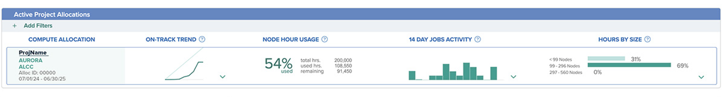

Select data for active allocations are shown on the dashboard of the MyALCF portal when you sign into an ALCF user account. The dashboard section labeled "Active Project Allocations" provides an overview of activity with allocation start and end dates, allocation node hour usage, remaining node hours, usage trend data for future planning, and job sizes run. You can make more detailed queries using the sbank graphical interface in the sbank section of the MyALCF portal. Further information on how to use the sbank graphic interface is available in the MyALCF documentation.
Dashboard Screenshot
An active project allocation on the dashboard provides an overview of allocation data.
