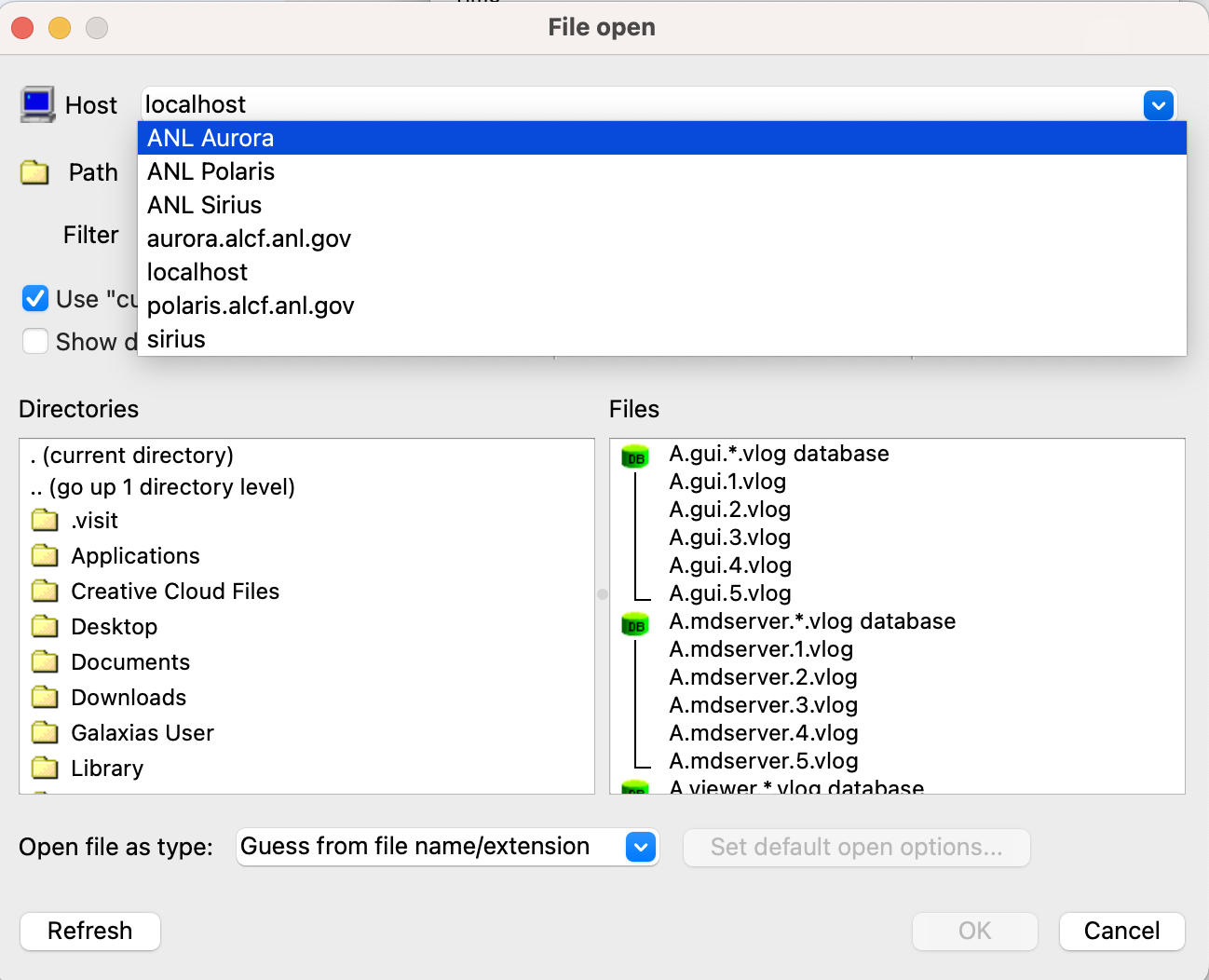

  • Click File -> Open File and choose "ANL Aurora" from the "Host" dropdown.
Open File
