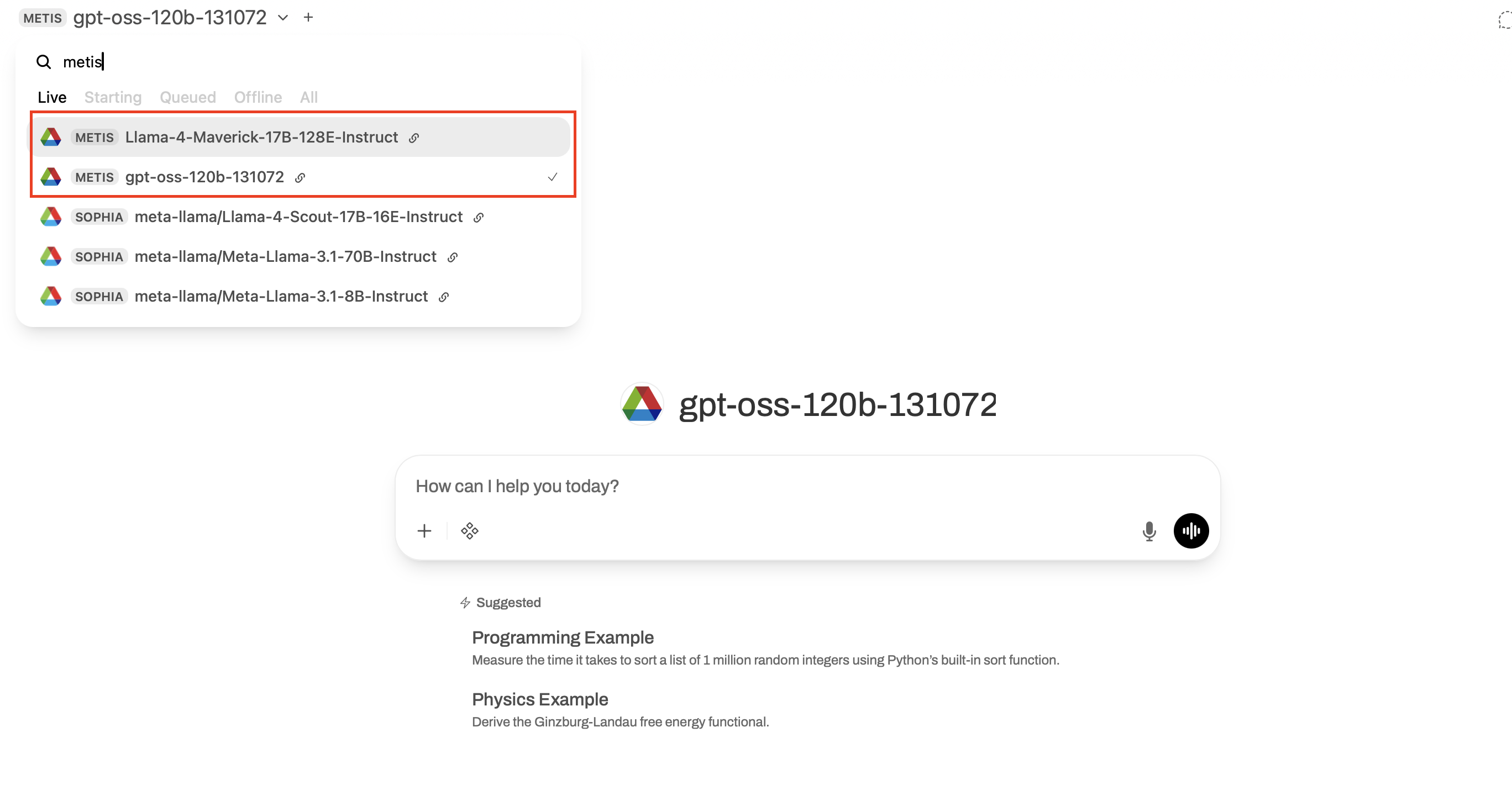

The easiest way to get started is through the web interface, accessible at https://inference.alcf.anl.gov/
The UI is based on the popular Open WebUI platform. After logging in with your ANL or ALCF credentials, you can:
  1. Select a model from the dropdown menu at the top of the screen.
  2. Start a conversation directly in the chat interface.
In the model selection dropdown, you can see the status of each model:
Inference Endpoints Web UI
  • Live: These models are "hot" and ready for immediate use.
  • Starting: A node has been acquired and the model is being loaded into memory.
  • Queued: The model is in a queue waiting for resources to become available.
  • Offline: The model is available but not currently loaded. It will be queued for loading when a user sends a request.
  • All: Lists all available models regardless of their status.
